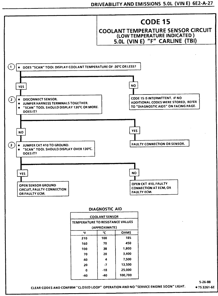

That is a good possibility since it sends infomation to the ECM about the temperature of the coolant so it will adjust the operating parameters of the engine. Here is a troubleshooting chart of the code 15 for you to use to find your problem. Hope this helps you out.

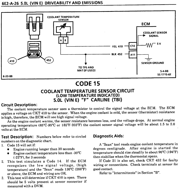

page 2

Since it is only intermittent, I would take a look at the connector on the CTS and check for broken wires, loose connection, corrosion, or a broken pin on the CTS. Pin "A" of the CTS connector is a ground wire that also goes to the MAT & TPS. It may not be the sensor but a bad connection. Use that chart above to check it out.
