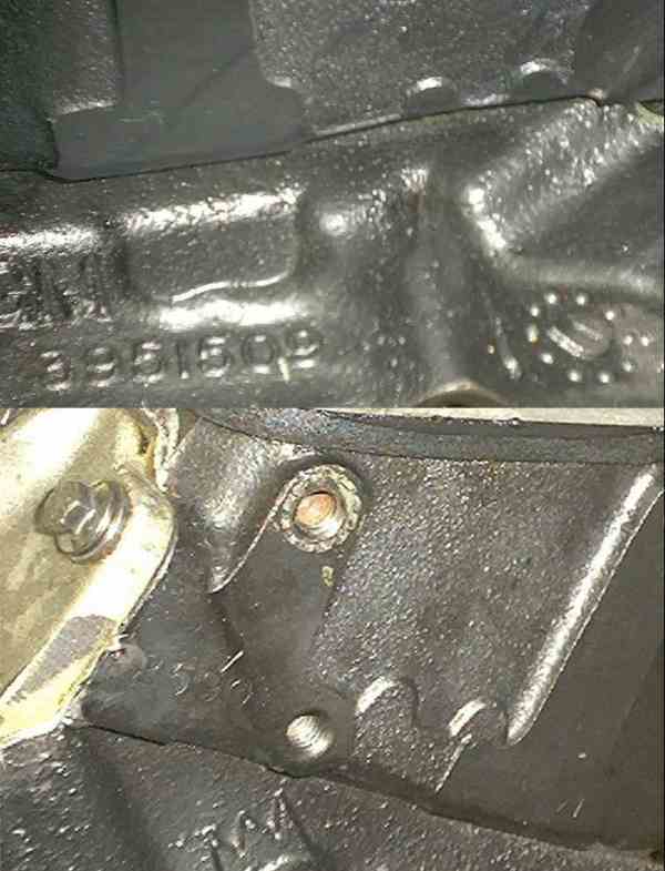

That's why the value of those heads in the world at large is exactly ZERO, in other words, that's why you got them for free.... that little myth about drilling and tapping those holes. Only someone who has never tried and failed like everybody else since the late 60s, would repeat that.
There's no metal there to drill and tap; and what little metal there is, is in the wrong plane. Heads with the right casting features have a bolt boss with some metal to drill behind the surface, and they have some extra metal on the outside too. If it was possible to drill and tap those holes so easily, those heads wouldn't be getting given away; they'd still fit cars and be useful. Somebody, in the last 35 years since they added the bolt holes, would have figured it out, and it wouldn't be a "well kept secret" either, and those old heads would still be worth something.
Don't trash what value they have left by trying it. Sell them and get the right thing.
Look at these, which are double-humps that WILL fit these cars, and you'll see the exterior feature that 462s don't have.

Yes there definitely are bracket setups that will work without the holes; just not the stock ones out of these cars, or nearly any other car since 69; and above all, not the serpentine systems.
They won't fit a 78 truck, for the same reason. That's why you got what used to be the most desirable set of heads in all of gearhead land, for free. They no longer fit anything that's been made in the last 30 or more years.
In addition, the double-humps without bolt holes, are also without the "squish" area on the side of the combustion chamber under the plug. That adaptation allows the later heads, like the 186s in that pic, to work with modern cat-pee gasoline in a high-compression street motor like 10:1, instead of requiring 98 octane or better like the old ones do.
Kind of sux, but the truth is the truth. People may come along and tell you what you want to hear, but them telling you that won't make the heads fit. There's a reason (at least one reason, maybe more) their PO gave them away.
