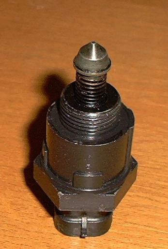

My '87 T/A is doing the same thing right now. I will take a look at the IAC but I'm not sure where it is. Can someone direct me? Pic would be great!

The IAC is on the throttle body. When you are looking directly at the TB it is the bottom left. It has a plug going into it and looks like a big nut. You have to unscrew it and it will pop out. I attached a pic I found on the boards of the IAC.
It should look like this. If the tip of it is extended all the way out then it is stuck. The easiest way to remove the IAC is to take the TB off the car, which is very easy.
