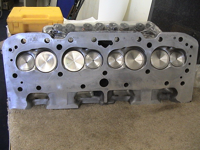

Can we assume your car is an '88 RS with 305 TBI?
If so, the heads aren't worth rebuilding, let alone porting.
601, 416, or 081 are the only ones you should consider.

You've got the "good" 305 heads. 305 rebuild parts aren't that expensive. Ported heads, good exhaust, good cam, matching torque converter, you'll have a nice running street car.
You could even have an emissions-legal one, but...

Here are a couple of good head options not mentioned yet. Either one would be great for a 305 buildup and be transfered to a 350 if you ever desire.
The first is the Topline Vortec replacements. The reason I would choose the Topline Vortec over the GM Vortec is for the thick deck. These heads can be milled to a 58cc chamber safely, in fact they advertise the capability for a 50cc chamber. These would be a great addition whether you decide to go supercharger or not.
The next option is discontinued but I was able to find a set with some patience off of eBay. That is the AFR 190 SHST which is a head designed to be the Corvette aluminum L98 replacement. The valves are small enough to fit a 305 bore. The chambers are 58cc. With a 190cc intake volume, I would guess these would be better with the supercharger than without.
