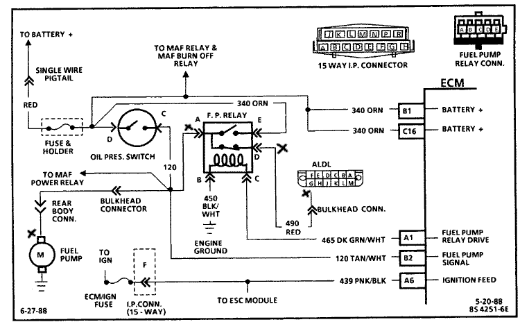

I fed current to terminal G on the ALDL port, and the relay clicked, but the fuelpump didn't start
I found a sparkplug wire was off (WTF). This could explain many things, but, if the sparkplug grounds out, could it fry the ECM / Fuel pump?
secondly, does the ECM control the fuel pump in anyway, and does feeding current through terminal G bypass the ECM, if it does?

The ECM controls the fuel pump through the fuel pump relay. BY going through pin "G" of the ALDL, you still go through the fuel pump relay but you bypass the ECM. Here is a drawing of it. You will notice a red wire goes from pin "G" of the ALDL to pin "D" of the fuel pump relay and then comes out pin "A" of the fuel pump relay as a tan/white wire and goes straight to the fuel pump. It also has splices to the MAF power relay, the oil pressure switch,and pin "B2" of the ECM. If the fuel pump doesn't work going through the ALDL, you either have a problem with the fuel pump wiring or the pump has seen better days.
