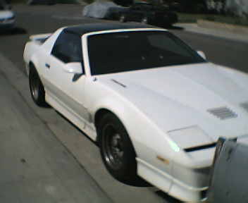

my car has been doing the exact same thing only worse...it won't stay running.....it happened quick just like that from one moment to the next.....
I replaced fuel filter and stuff ...still doing it....I am going to keep an eye on this post though let me know of you fix it

Hey I wrote above...I don't know what's wrong with your car but I finally traced mine back to the fuel pump. I first hooked 12v to the fuel pump test terminal (G) on the watchamacallit under the driver side dash and I could hear the relay click over but no fuel pump whirring. I then hooked 12v to the wires going to the fuel pump without the relay on it still no noise....then did the same thing and measured the voltage on the harness near the tank it read the approriate voltage....checked the ground...it was grounded and finally took out the tank and fuel pump and wired it directly to a battery and it just flickers on and off ...more off than on so I popped a new one in and if works wonderfully...thanks for all your helps!
