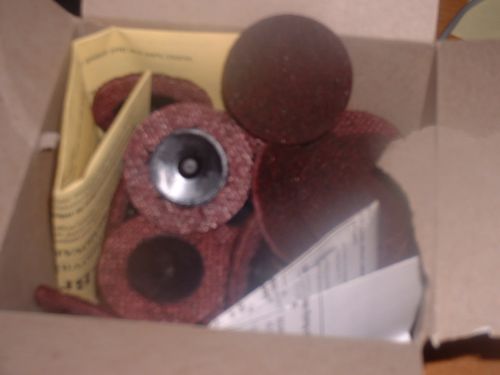

Well, happened to have a box I aint took to the shop yet, here's what they look like.
Attached Thumbnails How should I get rid of old gasket material thats left-rolocs-001.jpg
