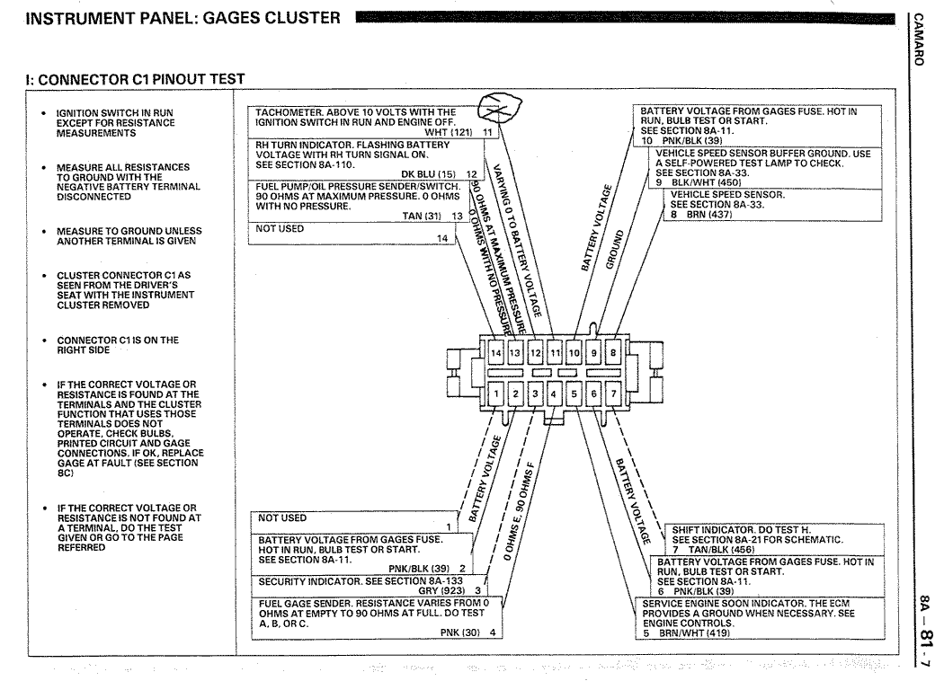

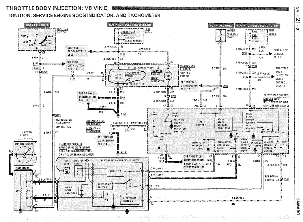

Check this. In this test, what you are actually testing is the voltage going to the tachometer connector on the instrument connector located on the right side of the dash. If the voltage is correct and the tachometer is reading wrong, you replace the tachometer. See the third picture for the pin number and location. BTW, I forgot to mention the wire for the tachometer is the white wire coming of the gray connector on the ignition coil. Before going to the instrument panel it splits off and goes to the ESC module.
