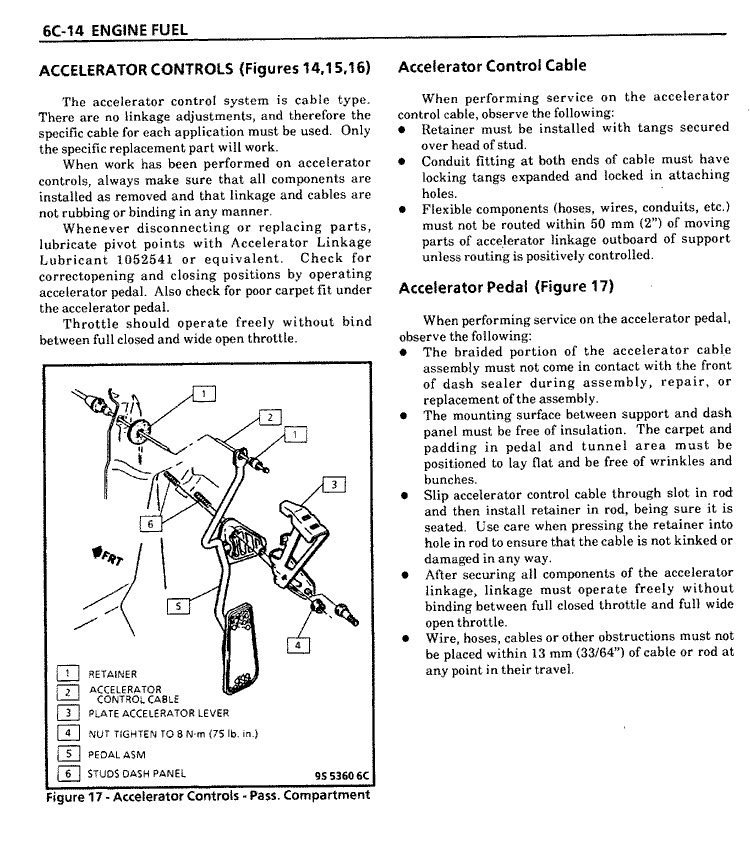

Hi guys, got the car running and everything is fine, however the gas pedal seems to be lower than before. I can "oick it up" aout 2-3 inches? Is there a way to fix this? I've gone through my haynes and Chilton manual to no avail.

Check this and see if it will help you any.

woohoo, that's what i'm looking for, just so i know where did it come from?

No problem Doc, it came out of a GM service manual for a 89 camaro.

thanks, i went to home depot and got a spacer thing, it's like a 1/2" bar with a slit in one side, slipped it over the cable, then pinched it down with some plyers. works perfectly.
