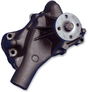

Before he removes the heads or anything crazy, demand a correct water pump. Even if he's eating the labor costs, it'll save time getting your car back on the road.
Like I told you in your other post, the easiest way to tell if it's a standard rotation post is to look for the threaded accessory bosses on the right side of the pump.
Here's a standard rotation pump and you'll see the difference.
Attached Thumbnails Too much pressure in radiator...something sounds fishy-pump.gif

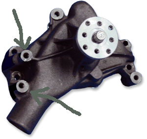

REVERSE rotation pump:
Attached Thumbnails Too much pressure in radiator...something sounds fishy-pump2.gif
