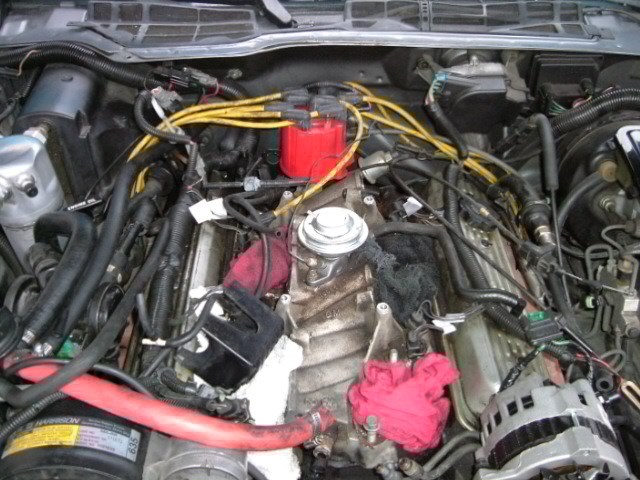

One line goes to a tank underneath the washer bottle, and I believe had a T in it with another line that ran back towards the firewall Can't remember exactly.
The other ran up behind the plenum to a weird conical shaped T fitting that then went into the rear vacuum port on plenum. The T is to the left and low of distributor cover in pic.

Then that would go to the port on left in Photo the one on right is fuel pressure regulator, you can see the tip of that conical T in the photo.
