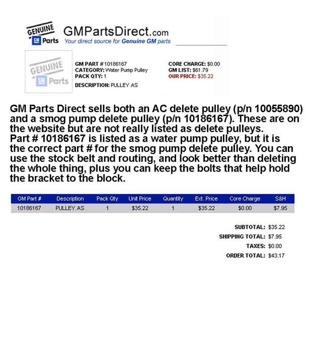

When I upgraded my '87 5.7 TPI v-belt to an 88-92 single serpentine system, I pulled the air pump and used the re-routed belt path with the longer belt. So far, after about a year, there have been no problems -- however, I notice the long unsupported belt section where it would normally be supported by the air pump pully, that there is a lot of belt flex which increases when the AC cycles on and off. I don't like the flex and live with the fear of thrown belts at high rpms, so I ordered the air pump delete pully from a GM parts house where it is known as a "water pump pulley." A bonus to installing it is that the two bolts that hold it in also support and strengthen the belt housing frame. GM developed this pully for export cars not requiring an air pump.
Here's the details -- GMPartsDirect.com GM Part #10186167 Water Pump Pully $35.22
Attached Thumbnails Can't Find Air Pump Delete Pulley-smog-pump-delete-water

Any chance of posting a few follow-up PICs of the part mentioned, both aside and installed? ;]
