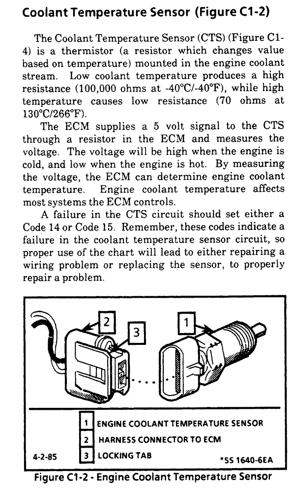

The "Coolant Temperature Sensor" has two wires and goes in the thermostat housing on the intake manifold. It tells the computer how warm the engine is.
The gage temperature sending unit is in the driver's side head between the two front spark plugs. It only has one wire going to it.

Sorry to hijack your thread but I have a question that has to do with the CTS.
I decided to check my SES light today and it gave me a code 14 - Coolant sensor high temperature fault. I remember when I was changing the coolant in my car about a month ago, I broke the prongs that kept the CTS attached to the thermostat housing and used electrical tape to keep it attached to the housing.
I'm wondering if this is a serious problem? I've been driving with the SES light on for a while and never seemed to notice any problems with drivability. Just decided to check it out of curiosity today.
Do I need to replace the entire sensor?

I assume you are talking about the sensor that is in the thermostat housing? If so, make sure there is no pressure in the coolant system and then you just unscrew it and screw in another one. It is important if you have an automatic. It determines when the lockup torque converter engages.

No, I am talking about the actual harness that connects the sensor to the ECM through the wire.
But thanks for letting me know about why it is important. I need to go to a dealership to grab one... AutoZone says they don't carry it.

About half of the locking tabs are broken off the sensor connectors on my underhood harness. They get pretty brittle with age, just a little too much pry when disconnecting and they snap.
Most of them I just leave as they are as long as they stay connected. All it needs to do is keep the seal engaged, as long as that's happening, you're okay.

That would be ok if it weren't three things:
1) The harness itself tends to fall out of the sensor... it won't just "lay" inside of the connector on the sensor. It pops out. I temporarily fixed it using a massive amount of electrical tape.
2) I am very dubious of the fact that the harness is actually doing its job. If I remember, I think the pins were bent when I tried to reconnect the harness to the connector and I had to keep bending them to make it fit into the sensor. I have a feeling my rough handling may have affected the stability of the harness itself (although the sensor is brand new).
3) The SES light is coming on. Obviously there is something wrong with the sensor somewhere.
I wish I had asked more questions before doing a complete coolant change... I went into that procedure totally blind of this stuff.
