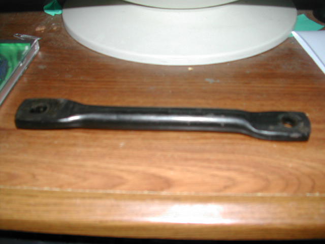

Wheres this bracket go?
Its the last piece of the puzzle. I took everything apart 8 monthes ago and I can't remember for the life of me where this bracket goes. I want to say its part of the HVAC system, but not sure.

looks like a brace for one of the acessories, alternator, ac ,or whatever. shouldm't be hard to figure out, find a bolt, or bolt hole, with nothing there and see if it fits.

if you have a serpentine setup..this bracket goes in the back of the right part...behind the alternator...this is where the mine goes on for my suberban.....

Also looks to me like the brace behind the Alt.

No, its not the alternator brace, its for the a/c (alternator brace would have one of the holes perpendicular to the other).. Its the a/c brace between the compressor and the front of the intake manifold.. There are two threaded holes on the front of your [TPI] intake.. The brace connects to the lower one..

ah ha, i remember now, thanks thirdgen88. but now ive got another issue, my lt1 intake doesnt have that hole. ive heard of people leaving off the other a/c bracket when doing headers cause it requires mods ive got that one, will i be okay without this one? but i guess i might have to talk to john about that one

extra parts! you dont need it...chuck it!
