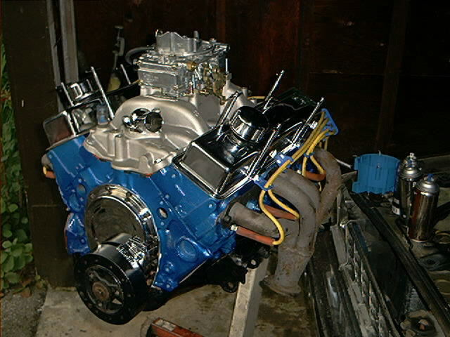

Hey guys, i know the deal of the guess how much horsepower i have game, but i would like to have an idea of what i did to my car.
I have a 305 that i built up with:
H.O. pistons
new bearings,
new rings,
Comp Cam 454 lift 277 duration, (dont know if thats @ .050)
Stock rebuild heads, shaved .020
Holley Street dominator intake (its like a mid rise intake)
Holley 600 4160
Mallory distriburter with high voltage coil
Flow crap headers
Flow crap Y pipe, (hey, those mandral bends on a stock size pipe must be worth something eh?)
Catco Converter
and a good paintjob with a bit of chrome (hey stickers ad horsepower for those honder guys so the chrome must be worth something. )
It runs real strong, i was kinda impressed.I have a T5, and i can chirp the tires in all gears, even 5th. (witch kinda scares me, ive seen 5th gear on a T-5, and i dont think i should be doing that) thats a cool plus.
But i want to atleast show you my lil' 305
Attached Thumbnails Ya, I know, another dumb guessin game, but im curious-engine.jpg

i'd say 225-245hp depending on how well it's tuned.

cool. i ran 15.65@92 mph. I think it should be a 14.9er when i get my rear tires and some suspension work done. My 60 foot times were 2.6-2.7
My buddy in a 89 formula with a 350 TPI ran a 15.23 at 88mph, but his 60 foot times were 2.2's
But thats what i get tryin to race on some 205/65 r14's
Thanks

You have times, speed, probable weights and gearing info. Go find one of the calcs online and punch in your info. Why didn't you post those originally?

Using the converted sea level times/mph in my sig, with 3450 lb race weight, the "standard" formulas said 250 RWHP for my combo.
