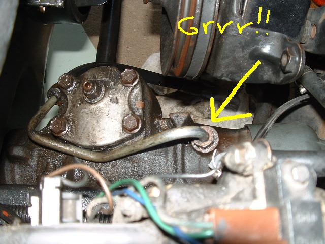

grr.. i got the bottom piece off. but the top ones still stuckk.. is there anything i can put on it to loosen it? luuube it up? theres not much room for a wrench. i can use a tiny one, but its useless.

are you replacing the hose ???? if so just cut it off and use a deep socket and take it off with an extension ...works every time
i know its not the "correct"way of doing it but it does work

:P just wat i did...got it thx!
