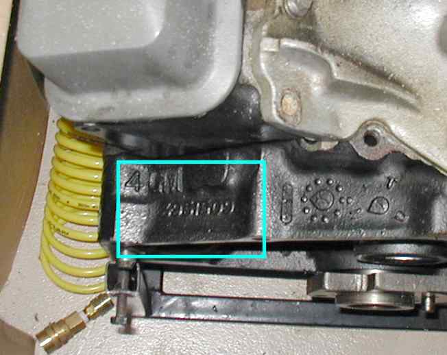

i found one number, seems almost like one, but its more of in the middle of the intake manifold. number 10088015, or is that just the tpi manifold part number?

It's right where the pic shows it.
I could be wrong, but that seems like it would be hard to see that place from below. I'd recommend you try looking from above. In the pic you can plainly see the intake, the place where the oil pressure sending unit goes, the head, the valve cover, and the bell housing flange. Those should be sufficient guides to point you to the spot.
No, the block casting number will not be found on the middle of the intake manifold. It's on the block. The manifold has its own casting number, which might be the one you found. It doesn't matter. It's useless for the task at hand.
The number you want will be in the place there that says "3951509" on my block.
