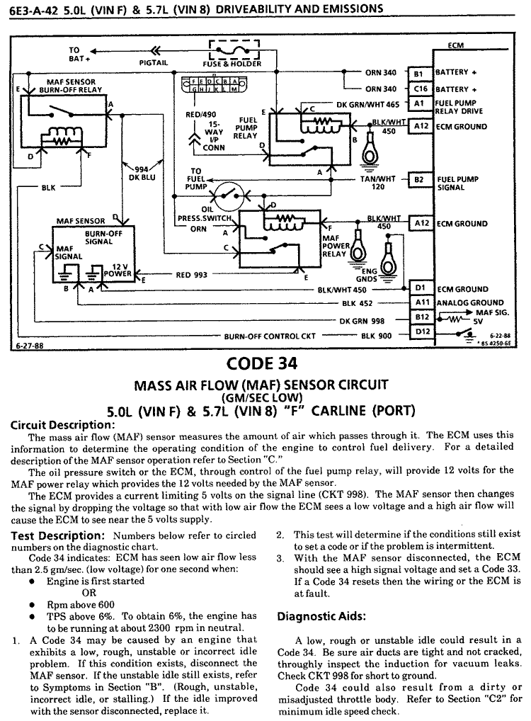

Here, this should help you.

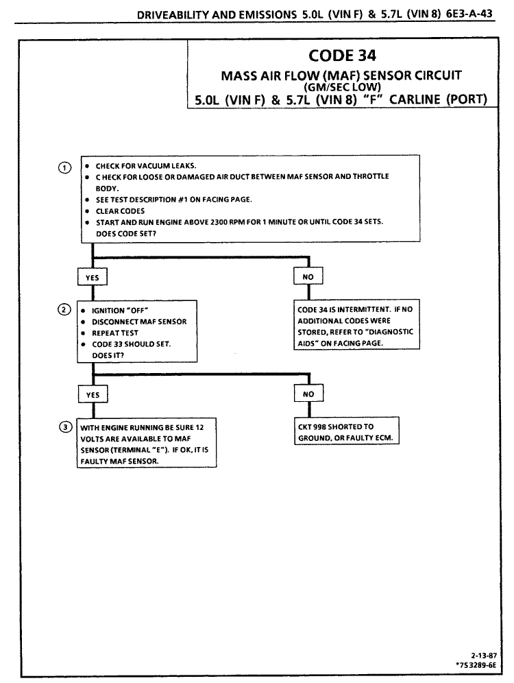

page 2

thankyou thank you . idid check this the same way and am pretty sure it must be the m.a.f. asi did get a code 33 when unhooking the m.a.f. butt didnt get any differance when un hookin .so iguess off to the parts store igo:hail:
