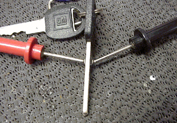

It is possible that you have a problem with the VATS since your keys resistance code is not being recognized by the VATS control module. Do you have two keys for the ignition on your car? Do this little test since you have a multimeter available. Set the meter to OHM's and measure the resistance on the keys pellet as shown in this picture and write it down. Next look under the dash and you will find a two wire harness that will be two white wires with an orange wrap. They will connect to another two wire harness that on your car should be a white/black and purple/white wire. On some cars they are white/black & purple/yellow. Disconnect that harness at the connector and put the key in the lock cylinder in the "OFF" position. Now take the multimeter still set to OHM's and measure the resistance value of the key through the two white wires and see if it is the same as the first reading. If it isn't, you have a broken wire on the lock cylinder inside the steering column. If it's the same, your prolem is elsewhere in the circuit.

I measured infinite resistance through the two white wires with the key inserted. I wiggled the key around and never got anything other than infinite resistance.

Replace lock cylinder!!!!!!!! Or if possible repair broken wire on lock cylinder.

OK. Am I correct in assuming that you have diagnosed my "no start" problem as a broken wire on the lock cylinder that needs repaired or replaced.

Yes, if you are not getting the same resistance value through those white wires as you got off the key you have a broken wire on the lock cylinder. And don't worry about that sticky tar on the starter enable relay, it is a sealant.

Trickster was indeed 100% correct in diagnosing my "no start" problem.
I inserted a resistor across the white/black and purple/yellow(?) wires and the car started right up. In this case the resistor was my spare key. I went to radio shack and bought some regular resistors but haven't tried them yet.
