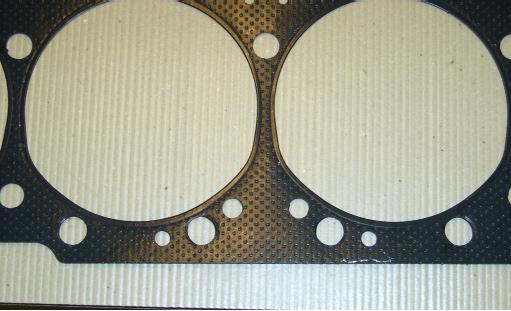

Which side faces the block? This side........
Attached Thumbnails Head Gaskets: which way is up??-s3600009.jpg

One side will have the part #s etc. stamped on it. That side goes "up".

Great, thanks. Now why the **** wouldn't it say that somewhere on the gasket or package?

Oddly enough, my Fel Pro gaskets did have the word "UP" imprinted on one side.

The last set of Felpro head gaskets I used had the sides marked too. These are Victor gaskets.

Just out of curiosity what would happen if you installed the gaskets upside down?

They will leak, it's just a matter of time.
