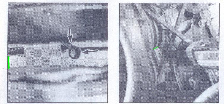

Ok I know I need to set my timing at 8* and i know i need to disconnect the distrubitor harness, and i found my timing marks, but i dont know what marks are what degrees, so can some one tell me or better show me a diagram or the timing marks?

lol that's my pic of my timing (the green lines) b4 i disconnected the dist harness

the marks before the zero, on the left, is btdc... after the 0, on the right, is atdc. set your car on either 6* or 8* btdc with the tan wire disconnected. hope that helped, later
