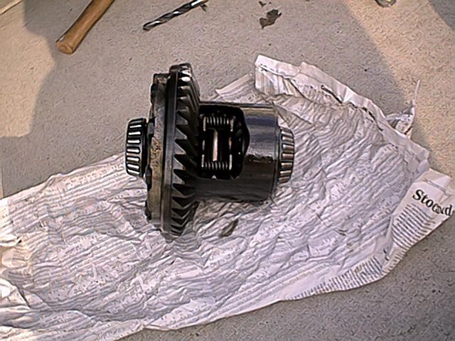

This is an 82, not very many 82's had posi. So its really not likely have posi. Have you taken off the cover and seen. Did it look like this?

nothing back there has been changed, but im not a car pro by any means.... so im guessing its a 9 bolt.....

If it's a 82 car, and nothing's been changed, it's a 10-bolt; and most likely not a posi (there being very very few of them in the early years, as mentioned), but the only way to know for certain is to take off the cover and look.
Lack of posi additive would not prevent a posi from working, if it has one; it would only cause it to chatter and groan going around corners.

The rear currently in my car came from an '82, and is a posi. But, I know that because I've had the cover off and verified that it looks like the photo posted above.

I'm confused about what you're confused about... sounds like your rear is working normally. Nothing to fix.
All you need is a posi carrier, of the appropriate series for your gears; which would be either a 2-series (3.08 or numerically lower) or 3.23 or numerically higher. The carrier would have to have side gears with the same splines as your axles, which is 26; 88-back had 26, 90-up have 28.
So while you have the cover off, count the teeth on the ring & pinion, or look at the edge of the ring for the ratio to be stamped there; you might see 40/13 for example, which is 3.08 (3.076923076923...). Order yourself the posi of your choice, such as Eaton, Auburn, etc. and a set of carrier bearings.
