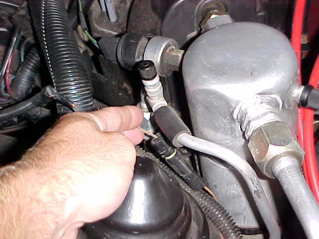

Hi all, Ive searched the boards and didnt come up with a clear answer. Ive borrowed a friends timing light and know to connect it to number one plug and point at the timing marks. I could not come up with where the "brown wire" is to disconnect the ESC and what I turn or adjust to set timing. Any leads to instructions or help would be appreciated. THX

The est wire should be on the passanger side behind the front fender well, you need to loosen the the hold down bolt on distributor and turn it to set the timing. I f ia m correct on this 305 's are set at 0*(stock) and 350's are set at 6* (stock)

This should help

Thanks to all for the reply and info. Shifty that pic helps big time!, thx. I hope its as simple to do as it seems.
