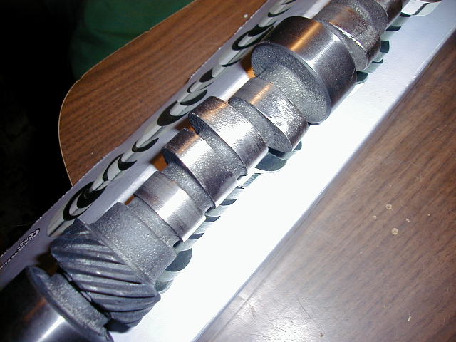

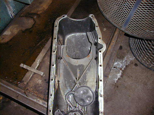

Here are a couple of pics of the lifter damage.

another pic.

Old Oct 16, 2004 | 09:07 PM
todd200's Avatar
Posts: 558
From: Bowling Green KY
Car: 87 IROC-Z
Engine: 350ci
So they did at least fix it before you picked it up right?

I thought I read on Comp's site about running a big cam and using a lighter set of springs for break in.
Wonder if your cam/spring pressures pertain to this?

Cams and lifters don't wipe out that fast, unless there is a SERIOUS problem somewhere. It usually takes one about a couple thousand miles to wipe out from simply a lifter not turning. Having multiple lifters not turning is an almost certain sign of a build malfunction.
You had a lack of clearance somewhere, period. Either the retainers hit the guides, or the coils stacked up, or the end of the rocker slots hit the studs, or SOMETHING.
Don't just change out the cam (even if Comp warranties it) and think you're going to slide another one in there and have it work. If the underlying problem is not found and fixed, it'll just eat that one too, just as fast. You need to find out what went wrong. Your shop should have done that; whether it's their fault or not, since they took your money for building it and it screwed up, they owe you at least an accurate and complete diagnosis. That's what you paid them for, was their "expertise": not just the service of turning some bolts.
By the way, this is why I build ALL my own stuff, to the greatest extent possible.

With that much damage you better check the bottom end as well. Bearings could be damaged. Right now I'd be screaming at that shop to refund ALL of your money and replace the damaged parts. They obviously F**ked up somewhere. Cams and lifters do not fail that quickly unless something is overlooked...and that's what you paid then good money to NOT do.

PS: I would look very carefully at the lifter bores.

pics of the engine apart.

Re: pics of the engine apart.
Originally posted by Blackroc86

So basically it took out every single lobe... still looks like an assembly problem to me. Looks like the whole thing never even had a chance.
Did you check the retainer-to-guide clearance AS CURRENTLY SET UP yet, and the coil bind height AS THE SPRINGS ARE CURRENTLY SET UP (not just what the "book" says they're capable of)? If they're slot type rockers, what about the slot length?

The engine is at the machine shop now and I am waiting for their quote. The metal shavings started the wristpins binding to the pistons. He said the bearings didn't look too bad.
As for checking clearances etc. that is a little too late now. I am not sure what way I am going with a cam this time. I definately won't be reusing anything from that misadventure.
Leaning towards a hydraulic roller now as I am not sure as solid roller would work with the Self aligning rockers I need to use on the Fastburn heads.

No, it's not too late. Sooner or later, you're going to have confront the obvious fact, that something slammed into something else that it wasn't supposed to; and if you don't find out what it is and deal with it, you'll be right back where you are now, within about the same 30 minutes or so of run time on your next build. Engine #2 will go up in smoke just like engine #1. The problem isn't going to just magically go away by curing some of the after-effects and symptoms.
What hit what? Where is the interference? Go find out, or make whoever you're spending your money with find out, because if you don't, you're in for a second rude shock.
Screw the bearings. Change them. That's a given, It doesn't matter what they look like, they're GARBAGE, and he knows it (or ought to....) Tell the moron to get his head out of his rectum, and pay attention to what really counts instead of being distracted by shiny things along his path, and FIND OUT WHAT HE PUT TOGETHER WRONG.
Catch me when it happens again, and I'll tell you how I really feel about people who don't get a clue when looking at the charred and ruined debris of their own mistaken handiwork.
Incidentally, the shavings didn't do ANYTHING to the wrist pins; it didn't run long enough. Tell them to leave that crap alone and concentrate on finding out what they did wrong.

Just trying to make a point.... personally, I think you're getting hosed. They're doing everything possible to avoid the real issue at hand.... which is of course, to find out why it failed in the first place. Be an educated consumer, and hold their feet (and any other more sensitive body parts if possible) to the fire, until they do the right thing, and troubleshoot the problem.
Otherwise, what I foresee happening, is they put it all back together, with the bomb still in it; it immediately goes up in smoke again; they tell you it's something wrong with your parts, it's all your fault, pay their bill ..... twice. And you're left with a large basket of scrap parts.
Don't let it happen.

I suspect coil bind at the very minimum. Did any one look up the specs for those Howard springs? I did. They are a 1.250" SINGLE coil spring. With the cam you have it is VERY unlikely that those will do the job. Edelbrock springs in there RPM heads are suppossed to be good to .575" lift ( I believe ). They are...as long as you don't rev it over 5,000 RPM. And what did you use for retainers? If the incorrect retainer was used, then you very well could have the spring below it's minimum installed height. Was installed height checked? Were the springs checked for coil bind?
As others have said. EVERYTHING, springs, pushrod guide holes, rocker slots ( Use using stamped steel rockers, retainer to guide clearnce ( actually...retainer to seal ) has to be checked for clearnace.
Don't mix and match components unless you know what you are doing. Buy the recommended Cam, springs AND retainers from one manufacturer and be done with it. Yes, you will have to machine the spring pockets....but that should have been done in the first place.
The hydraulic roller is definately a good idea though. These days there is know way I would even consider buiding a big flat tappet motor. It's either Hydraulic roller or Solid roller. Lots of manufacturers make street Solid rollers as well.
