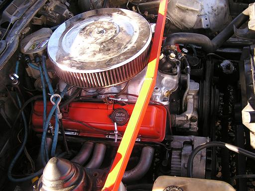

I replaced my intake manifold and water pump the other week, here are some pics. See if you can count the custom mods just to get these parts to work on the motor in accordance with the other parts!

On my left side head there was only 1 accessory hole, and my intake didn't have the bolt boss for the alternator bracket so i had to mod some stuff. To get the alternator to work i had to flip it over and but a turnbuckle on it for tension. I was kinda worried about it, but it turned out way better then i expected. The belts are just switched, the longer alternator belt is on the PS and the PS belt now drives the alternator.
