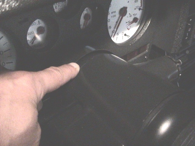

Stolen pic, would the torx bolts cause the problem here?
When I look at the 2 pictures the only thing I can think of is that the torx are long bolts, unless the 2 columns are completely different?
Pic is of where the movement is

that is where the picture vader posted is at the point where the column tilts

Yes. If that is the point of looseness, the four bolts holding the lower tilt joint to the lower column are probably loose.
The photo posted has four red arrows, which indicate the positions of the Torx cap screws. In that photo, they have been removed for an application of Loctite before reassembly. Don't simply tighten your screws, but apply a threadlocker, or you'll be back in there soon to do it all over again.
