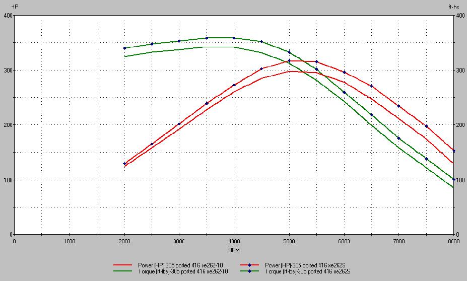

I was just looking through the comp catalog, and noticed that they had some XE solid lifter cams. Now i want to swap in a XE262 into my 305 this winter and was wondering hey.
The XE262H is 262/270, 218/224, .462/.469 110LSA
XS262S is 262/268, 224/230 .477/.488 110LSA
According to DD2000 the solid cam make alot more power. Has anybody run one of these? Any opinions about running one of these on the street? Thoughts....?

Did you tell it to run solid? I think that the manual (who reads those?) says to only select solid if it is a solid roller? Something like that??
Other than that...they sound cool! I say go for it Leigh.
*edit* looking back at the numbers you posted, it does SORT OF make sense. Comparing the advertised and .050" durations, the solid appears to have the slightly quicker ramp rates with a higher peak point. Opens the valve faster and to a higher point, thus, more power.

Yes those solid numbers are with "solid cam" selected. I've read the manual before but can't remember what it said. I guess its time to read it again.

I'm not sure about DD2000 and the valve lash, but i know what your talking about.
I just change the original graph, i had a .050 duration graph up there, now its seat-seat still set a s hyd and sld respectively.
I read(manual): 0.050-inch LIFTER rise for both intake and exhaust.
This measurement technique is based on the movement of the cam follower
(lifter) rather than the valve.
The 0.050-inch lifter rise cam timing
method measures valve timing when the
lifter has risen 0.050-inch off of the base
circle of the cam. In the setup pictured
here, the dial indicator is positioned on
an intake lifter; the 0.050-inch valve
timing point can now be read directly off
of the degree wheel attached to the
crankshaft. Timing specs measured
using this method are not meant to
approximate the actual valve opening
and closing points, instead their purpose
is to permit accurate cam installation. All
0.050-inch timing specs entered into the
Dyno2000 are internally converted to
seat-to-seat timing. Because there is no
way to precisely perform this conversion,
always try to obtain and use seatto-
seat event timing.
So they want me to measure the seat-seat measurements of a cam i don't have with a dial indicator.
