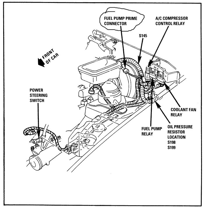

where is it located, and what do i look for when i test it?
Here is a picture of where it will be located in your car, it will normally have a single red wire to it. When you test it you should hear the fuel pump run.
