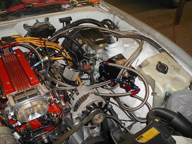

Hi
i got a 383 stroker with the miniram intake manifold, im going with a Procharger too. i didnt like the setup of fuel rails that TPIS sold for the miniram, so i tapped fittings on the rails and ran braided hose and i used an external aeromotive FPR. My problem is the same after the fuel pump stops priming my rails wont hold pressure. My injectors are not leaking cause i kinked the return hose that goes after the regulator and pressure stayed but i release the hose and the pressure dropped immediatly
jim
