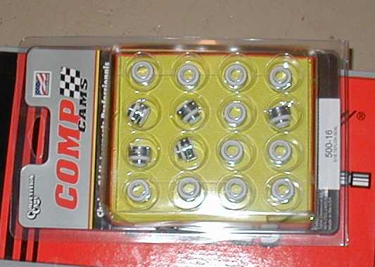

Hmm.... that bites, you can't even put a good seal on them. The good seals are all .530" or .500".
But if they're that big, then at least the bigger spring cup should sit still on them.
