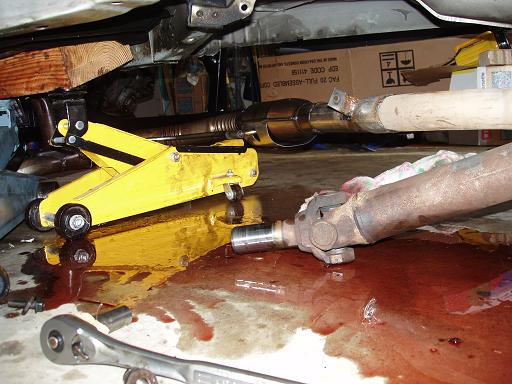

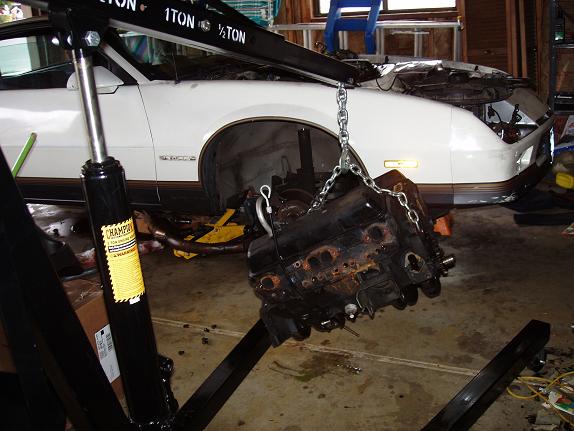

So to update with how it went... it went horribly lol.
I dont know what damage I've caused, but the engine IS out... and the driveshaft and panhard bar are disconnected from the tranny (more on that later). If I had hosting I'd post up all the pictures that I took (another 5 pictures that is).
Basically, I spun the flexplate around as much as I could and finally got a peak at the last bolt to the torque converter. So I grabbed a long combination wrench (box and open), broke the bolt loose with the box, then went at it with the open end for about 20 minutes a couple few milllimeters at a time lol.
After that I THOUGHT that I had everything squared away. So I started lifting the engine, I heard a clunk after a few inches up, figured that was the engine and tranny disconnecting themselves, so I kept lifting it up, then I heard another clunk about a foot higher. So I stopped, looked down and the tranny was all ****-eyed up in the air with the engine like I was afraid of. The initial clunk was the tranny and engine disconnecting what they could from each other, the 2nd one was the driveshaft and the panhard bar disconnecting themselves from the tranny (I dont know if it snapped any bits inside it or anything, looked like a clean break from each other, I just thought that they were bolted in, not pressed in? lol.
So I lowered the engine again, then I raised the transmission as high as I could, found that I had missed the last transmission - engine bolt.... for some odd reason I seriously thought I got all 4 of them. So I took out that last bolt, then I had at it again and it came out in a jiffy.
Thanks for the help everyone
