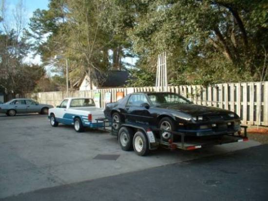

16' utility! 82" wide between the rails, 7000lb capacity, new deck boards, electric brakes on both axles- picked it up for $800.
I only towed a couple hours from home with the S10, for any serious hauling I'll borrow a full size truck.

IHI you sound like you really know your stuff about trailers and towing.
I hauled an 88 Mustang on a U haul car trailer with the S10 from Savannah to Tampa last October, and due to the tiedowns on the U haul trailer all the wieght ended up on the tounge. It really didn't tow too bad, the surge brakes on the trailer helped a lot, I could pull 70 with no problem (truck is 350 powered) but the 3" Belltech drop leafs are not towing friendly! We made the trip at night with no traffic just for this reason-.
When I got my own trailer and towed the Iroc in the picture I had the car too far back- it got a bit hairy on a long downhill at about 65mph. Once down to 55-60 it was fine. I need to get a brake box hooked up and sway control bars will help a lot. ALso for any serious hauling I'll beg borrow or rent a full size truck.
I want to cut the rails down, I can't cut them off becuase it will weaken the trailer too much, but I want to angle them front and back from the fenders to the corners of the trailer, sort of like a suspension bridge. I think it will still be plenty strong.
