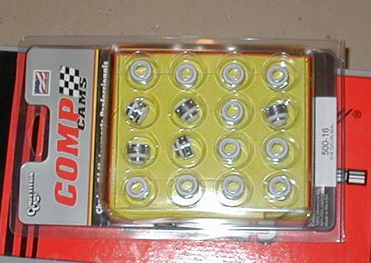

Otherwise, positive seals on the valve guide such as these, would have a very tough time.
If you're going to spend money to work on something, get the most bang you can for your buck. That tool is going to cost you somewhere in the $80 neighborhood when you finally find it at Manley or Isky. It costs the same to take the spring pockets out to 1.45" so you can use better springs. The better springs cost about the same. That 's what I'd do if I were you; get the tool that takes the pocket to 1.45" so you can use good springs such as Comp 986, the guide OD to .530" so you can use the Teflon seals, the guide height down to .600" or whatever it is so you can run the lift you want to run without the retainer smashing into the guide; all for the same price a sthe little bit of nothing you're talking about spending the same money to get.
Oh, I almost forgot, the seals....
