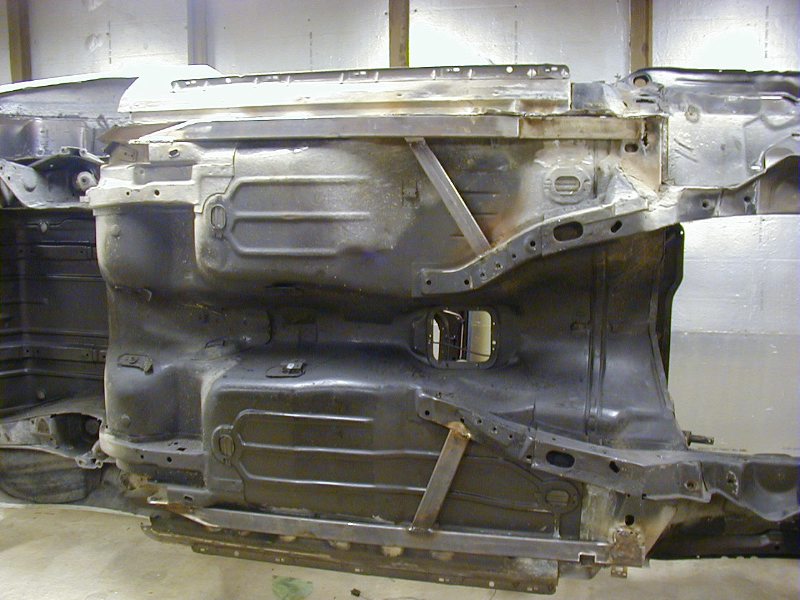

Here's what they look like. Notice the square tubing running down the sides of the car, and crossing toward the center to weld to the "frame" next to the transmission.
If you have to ask what they are, it's probably not a good idea to be doing the install yourself.... the car frame needs to be held straight and square, and if it isn't, the SFCs will hold it permanently in a tweak. For example, I had mine (not the car in this pic) done on a race car jig.
