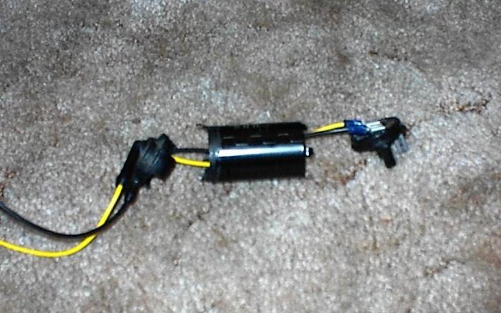

ok i thought about it and came up with the following solution:
step 1:
take out original motor.
remove both ends.
throw away the guts.
free the ends of the terminals on the inside by pushing away the copper area.
slide on a female connector (may have to widen a bit manually - not exact fit)
crimp wire and run through motor housing then water tube (requires careful small drilling to widen one of the holes)
at this point looks like:
Attached Thumbnails Anyone convert to "washer pump in washer motor" to "washer pump in fluid tank"?-step1.jpg

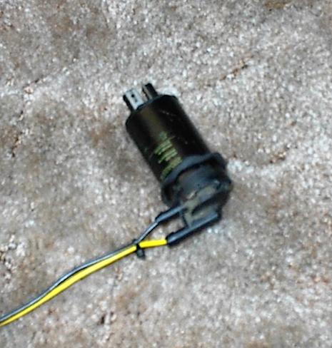

put it all back togethor and now looks like:
Attached Thumbnails Anyone convert to "washer pump in washer motor" to "washer pump in fluid tank"?-step2.jpg

now, just slide that into original place, and run the two wires to your new pump (inside the tank design).
after routing the wires and hoses, and using a shroud for the wires you wouldnt even notice it had been modified without further inspection.
and, it works GREAT. IMHO much better design.

the washer pump looks like the pic above and pops out the bottom easily.
the motor much larger and is attached to the whole assembly.
