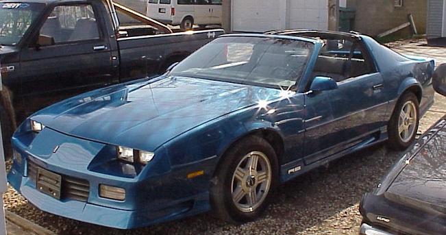

Ok so I take my 91 Camaro into a inspection station. He calls me five hours later telling me the following things are wrong with the car:
-Window Motor Bad
-Steer Collumn bad
-Bubble in the tires
-Trans-Brake
-Rear End needs rebuilt (Ill admit to this one making some weird *** noises)
-Broken Engine Mount
-Bad steering links (cant think of the right name im still in shock)
-Control Arms bad
-Alignment
-Windshield Wipers
-Brake Rotors
Some other various small things as well. Now when I bought the car about a month ago. I drove it..had a mechanic look at it. No problems generaly. It steered to the right a little bit. The paint is perfect. Interior is spotless....engine is also spotless. Brand new exaust, altanator, tires, etc. Nothing I thought to be wrong with the car. So I ended up paying about 4000$ with taxes, tags, and title. (80,000 miles by the way).
So I have two questions:
1. Did I get ripped when I bought the car?
2. Am I getting ripped by the mechanic?
If you have more questionso n the condition of the car feel free to ask. Thanks for any help. I just need to settle this in my head before I shell out some major money. I have attached a picture of what the cars condition looks like.

here is my 2c
looks like a nice car
as far as the repairs needed you could probabbly do most of them yourself with a manual. since you mention the steering coulum I am betting you mean its loose, and while I wouldn't fix it myself (because I don't feel that competent yet) all it should be is some loose bolts (a dealer quoted my 2hrs labor to fix it). now for my opionion (sp?) if you need a new rear end (I assume you are reffering to the diff) it seems to me that is a great excuse to put some different gears in. I'm not sure what a bubble in a tire is but there again is a reason to get some new rubber. anyways happy wrenching
