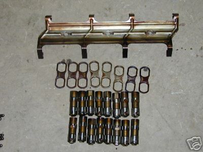

I can peek thru my heads into the lifter valley, although thy're fast burn aluminum head, If you can do this with L98 heads you'll se the spider lifter retainer if it's a roller.

Perfect , look in the big pit on top of the block and see if there is a flimsy piece of metal that looks -loosly- like a spider bolted in there. Or look for dogbones, etc.

Riiight, what he said.....LOL
It's a roller if you see anything like this...
(thanks to formulajokester for the pic)
Attached Thumbnails L98 questions-c-documents-settings-owner
