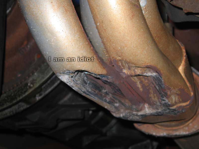

Your never going to believe this but just today i took out the Z was racing my roomates 350z, was going bout 100 and didnt see a huge ditch coming up.. it was just an open back road.. i hit it hard and bottomed out big time.. my hooker long tube headers are about 1/2 inch off the ground and i smashed them all in... now im hearing a ticking sound very loud, either i punched a hole through, or just popped out he header gasket which happens alot...
the real problem is once i hit the ground.. my rpms crapped out on me... while im driving if i give it gas , the rpms jump as if my clutch was slipping or something, but it jumps back and forth and the rpms jump up and down, lot of shaking and the check engine light is flickering on and off while im flooring it... i can drive it slow but once i try to accelerate this thing seems like its driving on its own.. maybe this is a sensor i messed up? im affraid i did alot of damage and done know what to do, the headers are banged up like over an inch up now any ideas? its driving like crap and i dont know what to do
please help!

also the tranny (t56) seems to be jerking around alot, and if i give the car gas at idle.. it will accelerate the rpms on its own for a minute, then fall back down... im clueless

You probably dented and if not cracked your oil and transmission fluid pans.Check them out and watch for oil leaks.Just a suggestion because I bottomed out before and cracked my oil pan.

I never realized how adversely an exhaust leak could affect my car's performance until I fixed the one I had. Get that taken care of first, and while you're under there look around for broken wires or vacuum lines, as well as leaks.

sounds to me like you bent up the exhaust. When your driving normal the air isnt moveing very fast and just barely makes it through your bent up exhaust, but when you get on it all of the air tries to get out at once and gets crammed in the bent pipe and that is why its studdering and everything else. Ive seen this happen when peoples cats get clogged. But as suggested earlier jack the car up and make sure you didnt bust your oil or trans pan and look every thing over. Sounds to me like you need new headers and exhuast pipes. Good Luck.

sounds like you may have bent the drivers side header into the slave cylinder for the clutch. no doubt, probably breaking stuff.

As far as the actual question, check your oil pan, engine crossmember and T-56 case. I think you pretty much know your exhaust needs to be re-worked.

A lot of crap in this thread. Just cut the guy some ****ing slack. If he's going to wreck it, he's going to wreck. No amount of you guys yelling at him OVER THE INTERNET will stop that.
WRT the post, where's your o2 sensor in the longtubes? I'd check that and then the slave cylinder. Do the paperclip trick to see what codes it's throwing. Paperclip in the top right two ALDL plugs.
