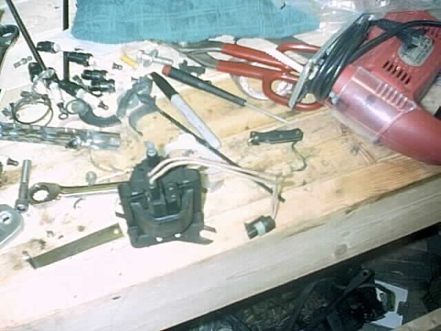

Just lenghthen the white and pink wires that go to the Distributor from the old coil that are shown in this pic. This way you can relocate the coil.

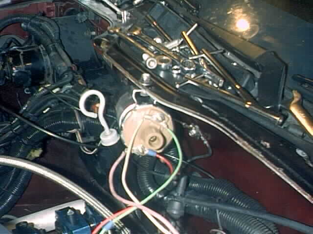

Cut the plug off the other Pink and white wires and attatch them to your new coil. White = neg, Pink = +

Yeah, you NEED those wires to run the ignition module inside the distributor- won't run without them. Cut somewhere in the middle, extend, and reconnect them to their original terminals.

Sorry I diddn't mean to confuse any one. If you just want to relocate your coil cut the wires and lengthen them.
If you want to use an after market coil, just hook both pinks (dist. and harnes) and both whites (dist. and harnes) to the new coil.
