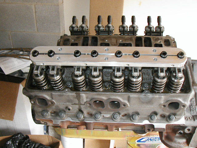

Ok just checking. I bought a stud girdle a while ago since my friend said it was a must. Here is a pic of my motor. Are those the same lunati lifters that you use IHI?

Same rockers and lifters
now if your runing the Comp .080 pushrods and BTE stud girdle you'd have my set-up!
Under hood ford solenoid is the only way to fly, make hooking up the bump switch soo much easier as well as other wires needing battery positive also.
You'll have to set your valves, install the girdle and then recheck them since it will true everything up and loosen some settings and tighten some other up or wont affect them at all, but you must double check them to be sure. Usually cold you set them about .003 LOOSER than called for since when the motor warms up it will expand that much and you should be right on the money or pretty darn close. So if lash is supposed to be .026, set the lash right now cold at .029
Regardless, once you shut the motor down after inital firing and while everything is still hot, go back through them all one cylinder at a time since your using a girdle that will allow that and check lash one last time since they will move somewhat. It may take a few heat/run cycles before everything starts to seat and then lash will rarley be a problem. You can check them to reassure yourself everythings in order once a month or every couple months but I know alot of guys that run it until they hear some tell tale ticking letting them know it's time to readjust.

Awesome thanks for the tips. This setup sounds so good. I already set the valves cold with my friend who has picked out the parts and has pretty much assembled this motor. My cam is slightly bigger than yours in duration with a 11:1 CR. We reset the valves last week after it warmed up but didn't have time to really hear it. What do you mean by under the hood celenoid and bump switch? Here is a short vid of it with open headers.
