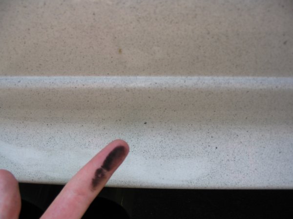

I have a 92 RS with the TBI, and its been running rich for awhile. There's always soot all over the back of the car, and it burned up a new cat in about a year (ouch). Sometimes I even get liquid out the back.

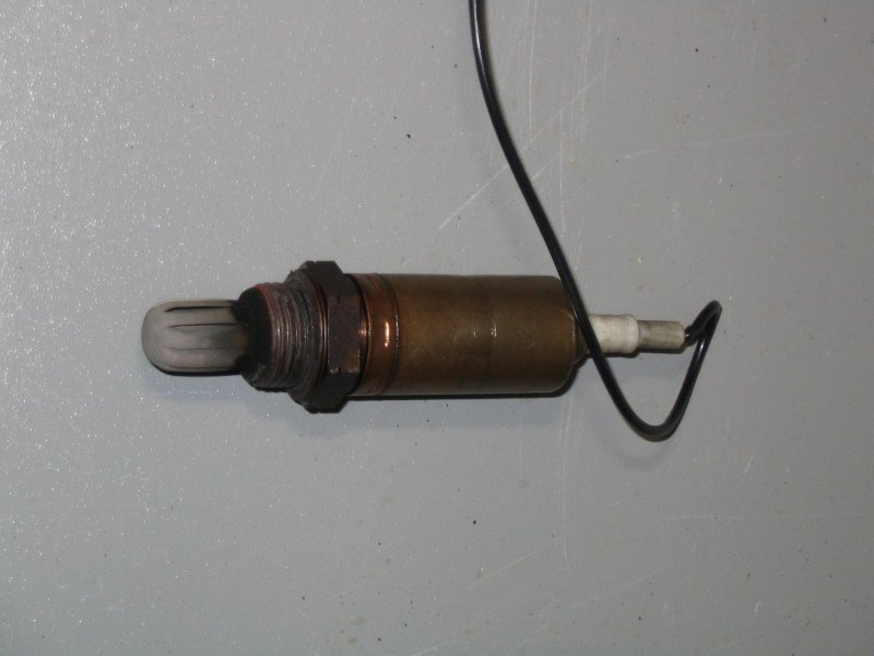

I pulled my oxygen sensor and spark plugs out. The tip of the O2 sensor looks gray, and the tips of the plugs look brownish. Does this mean anything?
- Mike

Yeah, to my (relatively inexperienced) eye, they look pretty normal if not slightly lean. They don't seem to look rich.
So if my burn is clean, where is all the soot coming from? Could it be ignition related? My timing is set at 0*.
- Mike
