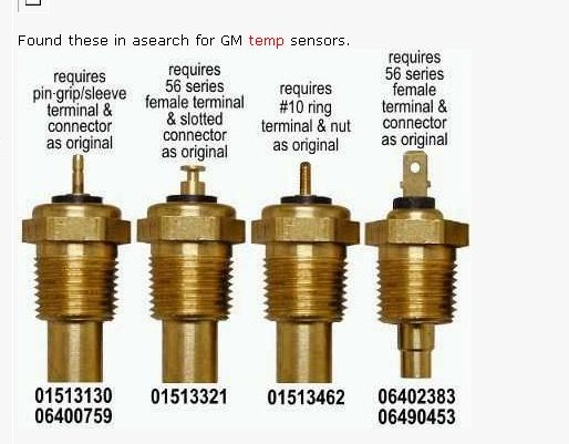

can anyone tell me the exact location of the temperature gauge sensor? I've been looking for it for a while and can't find it, thanks.

Look between #1 and #3 sparkplugs and a little below.

2nd one from the left is what I had in my car. kinda hard to see, but it should be there, this is what gives your temp sensor a signal not your ECM.

ahh ha...i found it....it was right there the whole time
