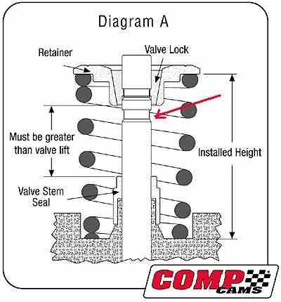

Since you have the heads off, machine the bosses. Have the springs set up by a shop, tell them your cam info. No point going through all of this again later.
You can use offset keepers, but to do that you need to check for clearance between the rockers and the spring retainer. If the retainer hits the rocker, you'll have problems again.
I think it's best you use a shop to set up your heads.
Umbrellas are normally used on the exhaust valve. If you look at the bosses, the intakes are flat topped. The exhausts are angled on stock heads. The bosses are normally machined to have positives on both.
Lose the rotater stuff. Use valve seat shims. Lose the oil shields if you kept them too.
You may have measured incorrectly. How did you measure the clearance? Did you measure the lowest point right on the retainer (right on the valve stem) to the valve seal? I find it difficult to believe your exhaust side survived but the intake side died.
Attached Thumbnails More bent pushrods...very confused need help-400-430-valvespringdiagrama-001.gif

I definitely measured it correctly, from the bottom of the retainer against the stem to the top of the seal. I guess its time to go to the machine shop. I still don't understand why the exhaust was fine even if I measured it incorrectly. I would have thought it would have been the same as the intake.

I was thinking you measured the bottom of the rotator to the top of the seal, so you may actually have more room than 0.453 on the exhaust side. But since you confirmed you did it right, I don't know. I have no clue why it survived, if you ever find out, do post. It's curious, unless all your exhaust lobes are wiped out, which is unlikely.
What do oil shields look like? I don't think I have them now anyway.
Oil shields look like a cup over the top of the valve springs. I forget the thickness. They cover the top of the spring to prevent oil from splashing down the valve stem. Totally useless if you maintain the seals appropriately or have positive seals.

Both the intake and exhaust bosses under the seal appear to be angled.
The seals all have 3013 USA and then another number that is different on each seal. I don't know what brand they are. Anyone know if these seals are bigger than normal or if they are the good kind?
I can't really get a good measurement on the installed spring height, but it is about 1.75".

Originally posted by rsn932
Where would I buy the attachment for the drill to cut down on the guide bosses?
Your favorite speed shop will have them. Comp Cams, Crane Cams, etc. Just about any of those companies have them. Look for a valve guide cutter or call the companies, summit, jegs, etc.
Take it to a shop. I don't want to see a "help! I ****ed up my heads" post. There may be some things you don't know, as you didn't know to check the retainer to seal clearance. Call around, get price quotes. Let them set it up for you, talk to them after they do it, find out what they did and what should be done so you can do it yourself next time, if needed.
Doing it yourself may (and has) cost you more than it would have to take it to the shop. I'd be hard pressed to say cutting the guides would cost more than one hour's labor.
