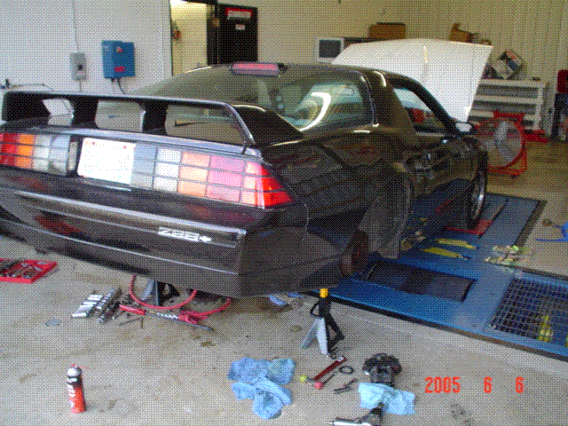

Well last week I took my 86 Z28 to the new dyno right up the road from my house. Made the first run and put down 287 hp at the wheels and 337 ft lbs torque.
The second run....:
He started out through the gears all sounded good got it into third and starting bring the rpms up then hammered it and got it up to 5200 let off and started to put it in neutral when BAM car jumps back off rollers. We had no idea what happened i looked under the car and saw gear lube pouring out the rear end. so we jacked it up and pulled the rear cover, turns out the pinion nut backed off and jammed itself into the posi unit which locked both wheels.

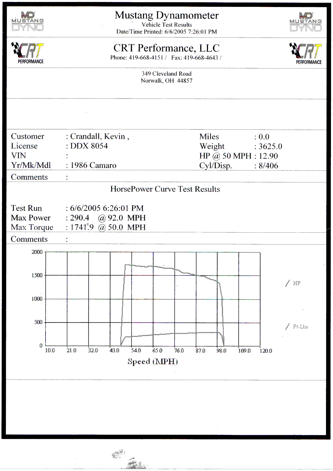

Still kind of dissapointed with the HP was expecting atleast mid 300's. The last run showed 290HP. The motor specs are as follows:

pic of car apart

second run dyno sheet, the guy said when the car jumped off if must have messed up the torque reading

first dyno run sheet
