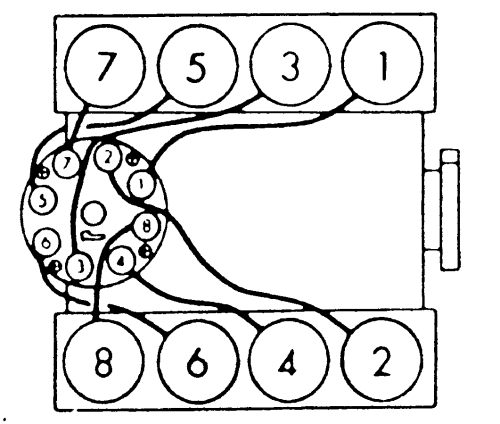

sellmanb's Avatar
Joined: Jul 2004
Posts: 1,840
From: Tigard, Oregon
Car: '86 Berlinetta
Did you use the distributor cap and rotor from the junkyard distributor?
Is the coil in the cap? If so, did you reuse that one as well? What about the ignition module?
Double, triple, quadruple check, and then let someone else check, and make sure that your spark plug wires are routed correctly! (check this first)
Old Jul 8, 2005 | 12:21 AM
bolinger89z's Avatar
Joined: Nov 2004
Posts: 64
Car: 89 Iroc z
Engine: 350 TPI 5,000 miles on new engine
Transmission: 700 R4
i used everything excpet the cap, then inside was tabs were really dirty and, i changed the rotor button too. Everything else was fine. I took it to the shop today and the guy told me he thinks it's the shaft on the distributor or sometjhing. he said that it's not letting all the cylinders get spark. But i don't really know if hes right or not. he didn't even take it out to check so i donno how he knows. I personally don't think it's the shaft b/c i changed the old one to this and it ran fine for like a day, then it started acting up again so i don't think i got 2 distributors w/ the exact same problem. I'm gonna talk to him about it tomorrow and see what he thinks. but i plan on picking it up tomorrow and not let him do anymore. the wires are right. i've checked like 500 times. thanks
