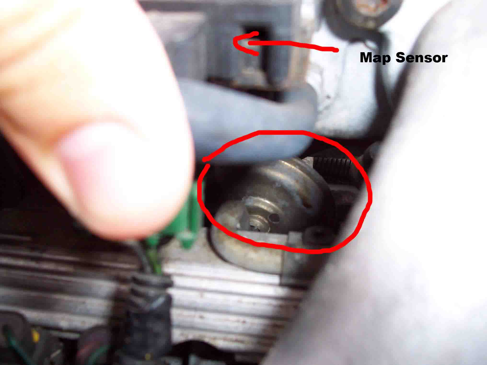

Here is the picture you requested of the vaccume-pump looking thing. It is attached to the egr valve(not pictured) by a vaccume hose. The map sensor label is for reference.
As for the code 42 and 43, i'm pretty sure the 42 disappears when the est bypass is connected, but the code 43 persists. I will confirm this tomorrow. Is there any other test you can recommend aside from the voltmeter test on the knock sensor harness which would give me a better idea of what component is malfunctioning. Keep in mind that the computer and knock sensor are both new.
Another symptom the car is experiencing is a sinusoidal idle of about +/- 100 rpm around the 600rpm mark. I'm pretty sure this has to do with the codes i'm throwing. I don't hear any hiss in the engine bay which would sugest a vaccume leak.
Sorry for the size of the image, this my first attempt at attaching a picture.

Just an update, I disconnected the thing that resembled a vaccume pump, and it is not a vaccume pump. Hot, what i assume to be exhaust gas, came out of the port which it was connected to. So I have no idea what it could be, a heat dissipator perhaps, but then there are still the two ports comming out of the end of it. But, i hooked all the lines up, and reconnected the est, and my code 32 and 42 disappear, all that is left is code 43, for which I am at a loss. I'll take the car for a ride to check for drivability/power compared to how it was before.
