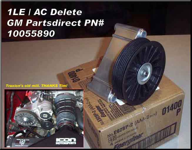

I have a 305 tbi serpentine set up (electric fan)
Im going to remove the A/C/ and needed help on doing so, also is this the correct ac delete pulley?

You'll only need the smog delete, if you're taking of the smog pump.

i dont know about ac delete. i just know that they make a pulley to keep ur setup the same. as far as the smog pump. its directly below ur ac compressor. and that box u asked about is part of the same system. u can literally unbolt the pump, pull out the plumbing; the only thing is u will need to get sum plugs for ur manifolds (local hardware store). and ur set... i dont wanna get into the bicker over smog... but it was easy. oh and u'll need a 96.8" long 6 rib belt. this tech article is where i got my info when i did it. https://www.thirdgen.org/newdesign/t...rpentine.shtml
do a to find out exactly what size plugs to use in ur manifolds. i got all my info from these forums...

If your deleting the A/C, have the system discharged, remove all the A/C related stuff, put the A/C delete pully in place, and your done...
