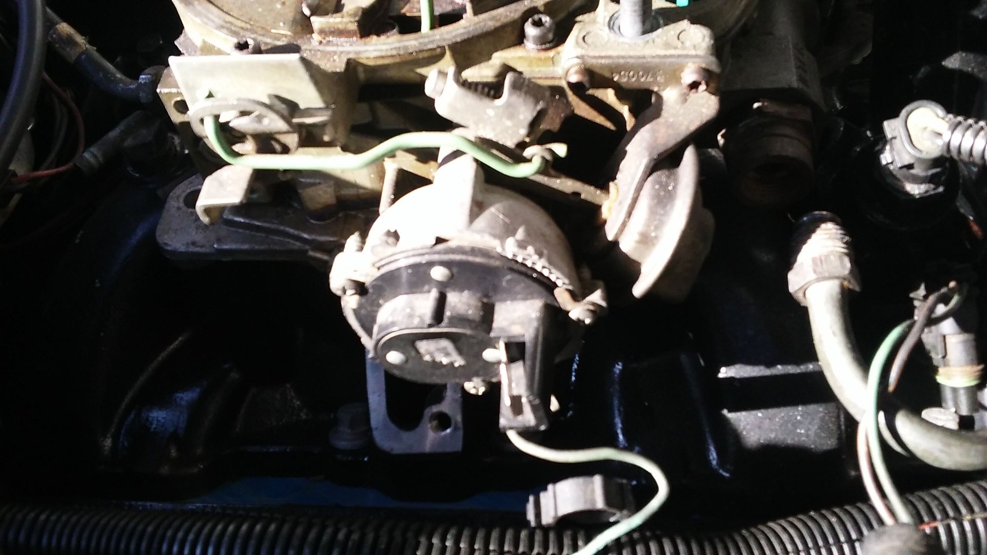

Sirs,
I brought an supposed used 2101 Edelbrock performer intake manifold from Ebay. I can't figure out what style of egr valve is supposed to be on this one. I brought an adapter that was supposed to bolt to it (from Edelbrock). Can someone tell me what EGR valve (or year and model) bolts to this manifold, or possibly what Edelbrock model # is this manifold?

Is this a manual choke provision instead of an egr provision?

Woah. You re-birthed an 11 year old thread my freind. This isn't the way to get help for your problem, especially since the original thread was for a completely different issue. My first advice is start your own thread.
That opening appears to be for EGR. Mounting the valve requires an adapter that is available from Edelbrock. I would suggest a call to Edelbrock tech support for more info. That manifold appears to be a Performer, most likely P/N 2104.
