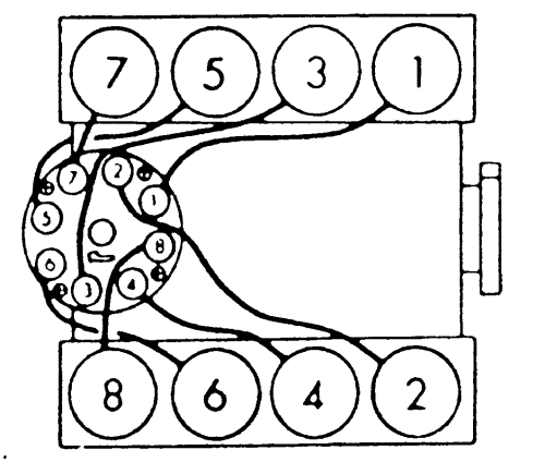

Originally posted by DanTheMan_smlk
how do i find out what cylinder goes to each post

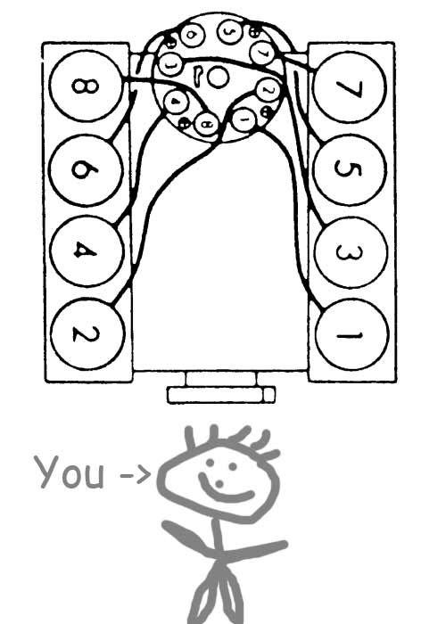

Why don't you just follow the picture I posted? Run the wires JUST like in the picture. Here I made it easier for you:

obviously the rotor has been moved by the previous owner so that picture doesnt help because i already tried that
ROFL!
