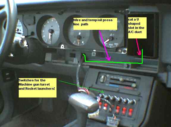

I made a hole in the fire wall just to the left of the distributor. ( driver's side)
Actually on my car there was a hole there already, just had to make it larger. push a coat hanger wire or what ever in there to use as a "fish". It came out near the top of the gas petal. Then run a "fish up to the dash hole like in the pic.
The air conditioner/vent duct is sealed off so I just cut a slot in the end of the duct to feed the wires and lines thru.
See in the pics. Hope this helps ya . I hate working under the dash!!!!

Here's some pics

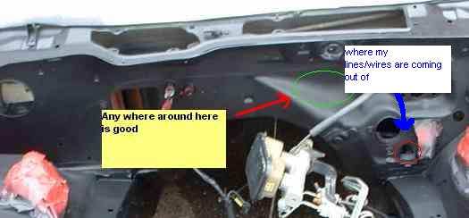

Ok i peeked around a bit while i was cleaning out the car, didnt have times to mess with the gauge. I notice a large rubber gromet over near the brake booster, and then possibly another one slightly to the passenger side of the engine, below the heater hoses.
Are either of these the ones you were talking about? If you can get a picture of the firewall and circle the area to which youre referring that'll help me greatly.

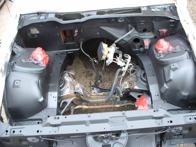

heres a pic i found(thanks whoevers car this is). if someone can circle the area mw66nova is talking about i'll be on my way to finishing this up.
Is it the hole in the photo with the wiring still coming through?

this is where i'm talking about:

thanks got it in. 180 at idle (warmed up)
